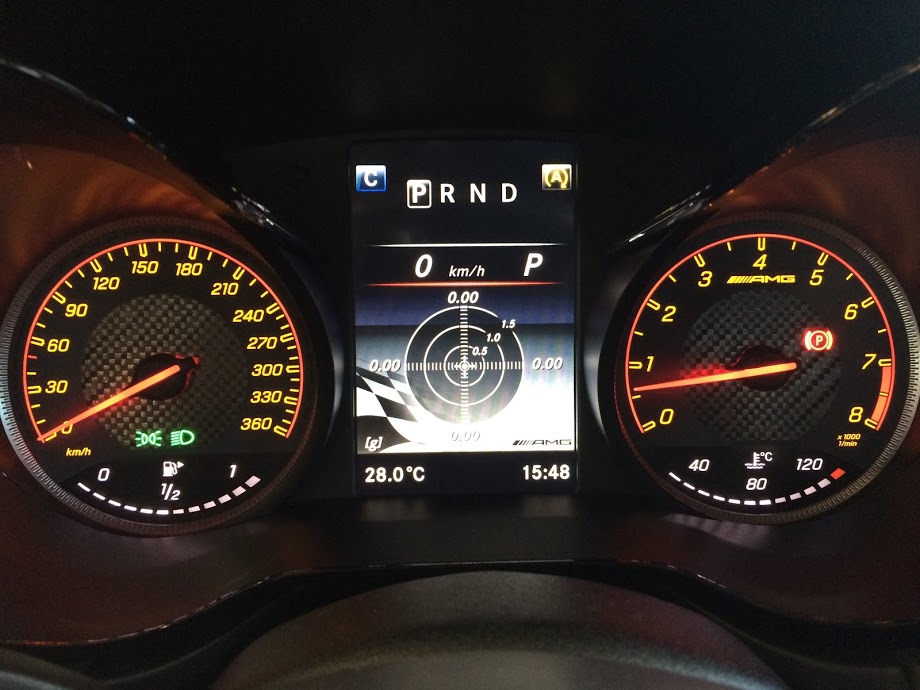

https://photos.google.com/photo/AF1QipO ... 2lRwb2cYcU

jacob12 написа: ↑19 Фев 2019 21:14 https://photos.google.com/photo/AF1QipO ... 2lRwb2cYcU
Error 404
