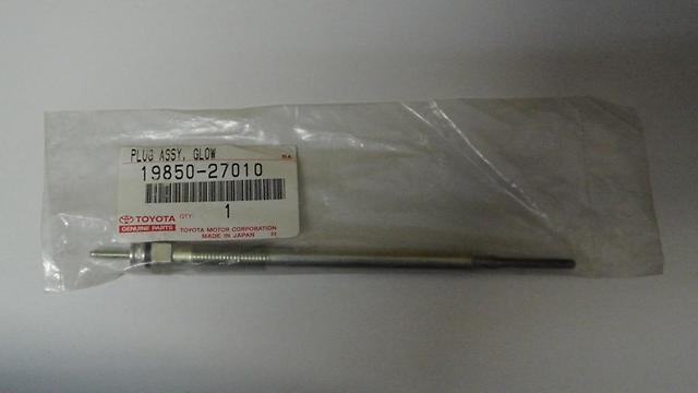

Свещи:2006 TOYOTA COROLLA (CDE120L-DEMNXW)
SOL UKP EUR SED LHD 1CDFTV DCRL MTM 5F
Реле:19850 PLUG ASSY, GLOW
19850-27010 BOOST VENTILATOR-GV=12V-11V 4 € 36.76
19850B GROMMET, SCREW(FOR GLOW PLUG)
90189-04024 4 € 0.78
19871 CONNECTOR, GLOW PLUG NO.1
19871-27010 1 € 6.96
Ето още четива - http://www.toyotabg.eu/viewtopic.php?t=28218.28610 RELAY ASSY, GLOW PLUG
28610-67010 1 € 69.37
Успех.
