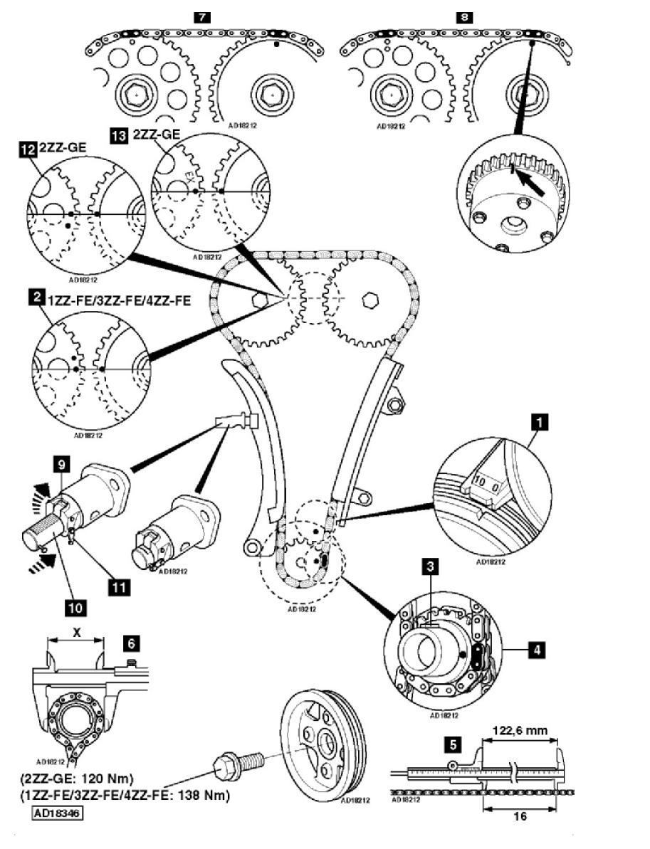

колеги сменях гарнитура но изпуснах веригата и сега като завъртя коляновия вал буталата опират в клапаните как се зацепва моля за савет !!!

А защо пипаш без да си свалил ремонтна документация ? При полжение ,че имаш и променливо газоразпределение си егати камикадзето ! Виж потърси тук http://toyotabg.eu/viewtopic.php?t=2185 или по торентите за repair manual за твоя модел и чети внимателно какво са написали хората !

Колега, дай някакъв мейл да ти пратя една схема с описание как се зацепват, че тука във форума не ми приема pdf.
Hi-Ace 1979, 2.2 D, manual
Special tools
Crankshaft pulley holder - Tool No.09213-70010/11.
Crankshaft pulley puller - Tool No.09950-50012.
General precautions
Disconnect battery earth lead.
Remove spark plugs to ease turning engine.
Turn engine in normal direction of rotation (unless otherwise stated).
Observe tightening torques.
If fitted: Mark position of crankshaft position (CKP) sensor before removal.
Do NOT turn crankshaft via camshaft or other sprockets.
Do NOT turn crankshaft or camshaft with timing chain removed.
Valve timing procedures
Ensure crankshaft pulley and timing chain cover TDC marks aligned [1]18346.
Ensure teeth timing mark on each camshaft sprocket aligned:
1ZZ-FE/3ZZ-FE/4ZZ-FE [2].
2ZZ-GE [12] or [13].
If not, turn crankshaft pulley 360°.
Remove chain tensioner, tensioner rail and chain guide.
Check chain for wear:
Fully stretch chain.
Replace chain if length between 16 links exceeds 122,6 mm [5].
Check sprockets for wear:
Fit timing chain to crankshaft sprocket.
Manufacturer: Toyota Model: Celica (99-) 1,8
Engine code: 1ZZ-FE Output: 105 (140) 6400
Tuned for: R-Cat Year: 1999-04
Replace sprocket if diameter 'X' at chain rollers is less than
51,6 mm [6].
Fit timing chain to camshaft sprocket.
97,3 mm [6].
Check chain guide grooves for wear: Maximum 1,0 mm.
Ensure crankshaft sprocket keyway at 12 o'clock position [3]18346.
Celica/RAV4: Fit timing chain ensuring marked chain links aligned
with timing marks [4] & [7]18346.
Avensis/Corolla/MR2: Fit timing chain ensuring marked chain links
aligned with timing marks [4] & [8]18346.
Reset timing chain tensioner:
Depress ratchet [9]to release tensioner plunger [10].
Push plunger into tensioner housing and lock with retaining clip
[11].
Install tensioner.
Turn crankshaft anti-clockwise slightly.
Release tensioner retaining clip [11]18346.
Manufacturer: Toyota Model: Celica (99-) 1,8 © Autodata Limited
2004
Engine code: 1ZZ-FE Output: 105 (140) 6400 25.02.2011 г.
Tuned for: R-Cat Year: 1999-04 V5.373-
General precautions
51,6 mm [6].
97,3 mm [6].
[11].
Install tensioner.
2004
