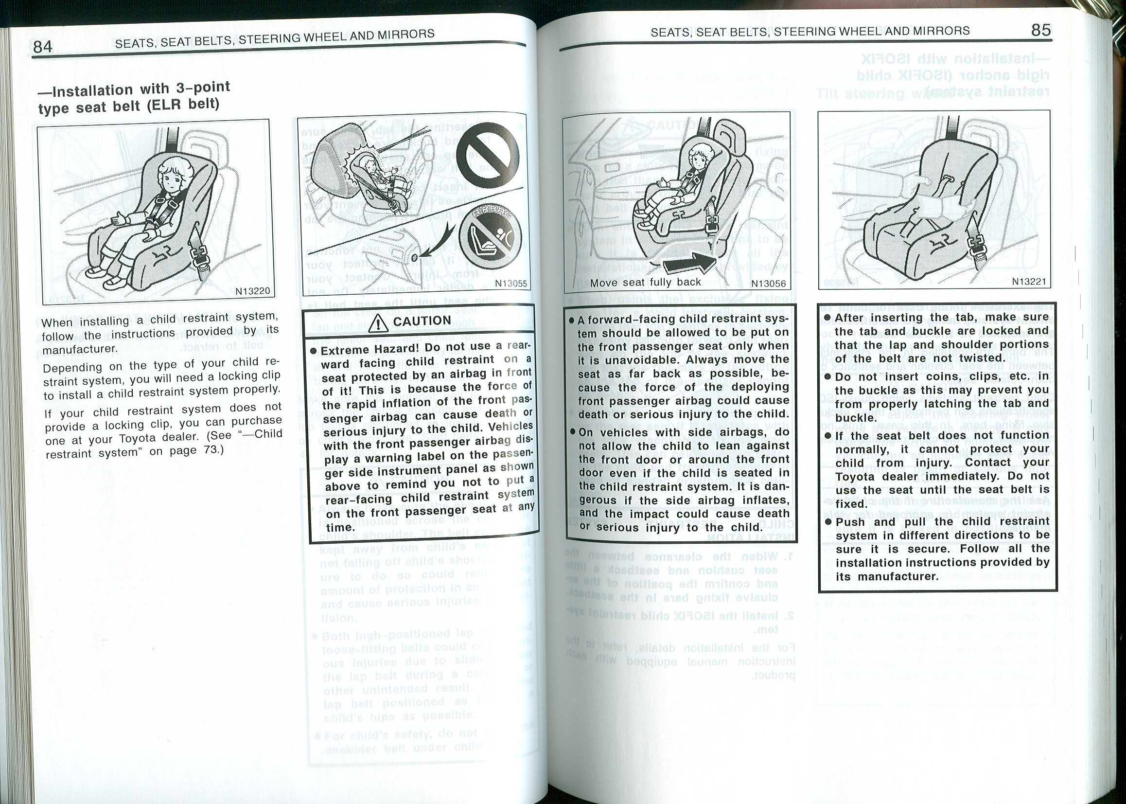

Аз не бих рискувал:Petar написа:Pyk i to mai moje dase sloji i stol4e i bez dase izklu4vat aerbecite
А forward-facing child restraint system should be allowed to be put on the front passenger seat only when it is unavoidable. Always move the seat as far back as possible, because the force of the deploying front passenger airbag could cause death or serious injury to the child
